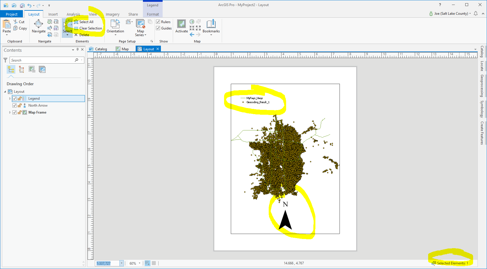

Kory-  Added a new layout to the Northridge Project with just the 2D map frame added.  After adding a north arrow, legend and scale bar I am still unable to select using a select tool.  I also added some of my own data to a whole new project.  Same thing; can't select with any select tool
Something else I noticed is  if I select an element from the contents pane, the grab handles for that element appear, and there is a message in the lower right corner telling me 1 element is selected.  But.... I can use the select tool to unselect the element with a single click anywhere in the layout; at least the grab handles disappear but the message still says one element selected and the Clear Selection button in the Elements group is still available. Obviously that element is still selected.  Perhaps that is how it's supposed to work?  We should probably move this to a new discussion, rather than adding to this question thread.
