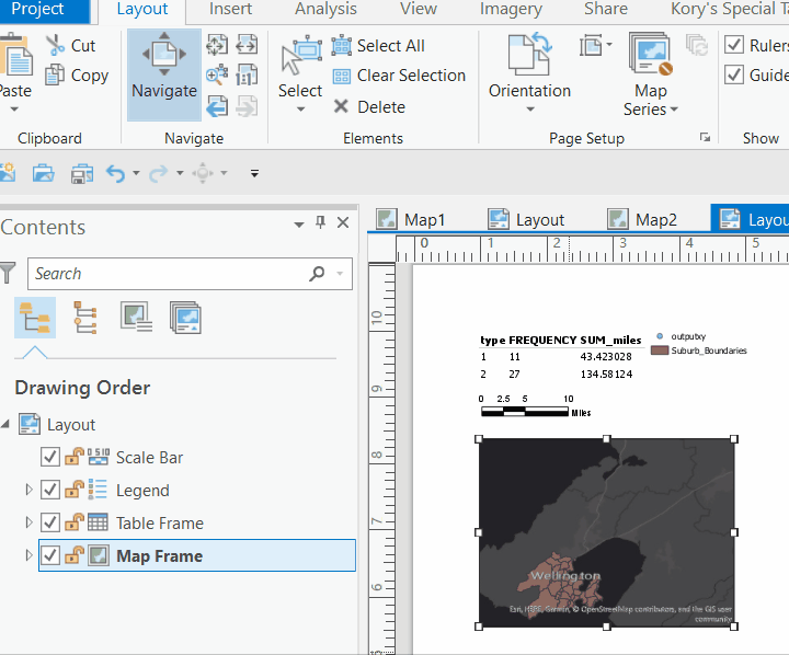

Is there a trick to selecting the elements?  I can't seem to get them interactively, only by a single click with in the contents pane.

Hmmm, silly question, but do you have the Select tool activated?
JoeBorgione
MVP Emeritus
Yep.  Doing just what you are demonstrating above, but none of the select tools are working for me.
