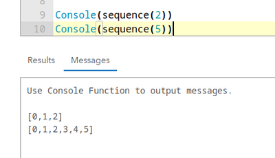

There's nothing built-in that does this, but you could easily create your own function:
function sequence(threshold){
    var out_arr = []
    for (var n=0; n <= threshold; n++){
        Push(out_arr, n)
    return out_arr
- Josh Carlson
Kendall County GIS

That's perfect thanks Josh  😄
