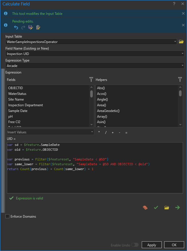

JohannesLindner
MVP Alum
Export your table to a gdb and run either the Field Calculator or the script on that exported table. If the errors persist, I'm absolutely out of ideas.
Have a great day!
Johannes

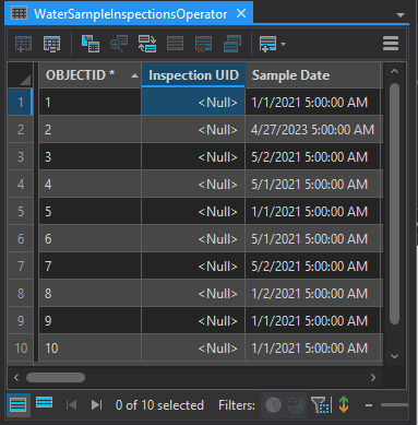

BrianHumphries1
Good morning Johannes,
I am able to run the Arcade expression on the table Inside of the FGDB
My data does have identical values for the for the sample date

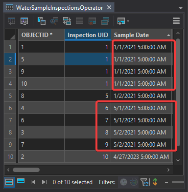

see below
Results after running the Calculation and sorting by Sample Date
It seems that the codeworks after the first identical values change, Then its picks up the next record count after the first set of identical records are ran through.
So in this example I had 4 records that matched the same sample date in ascending order ,
then it picked up the count of 5 after the first set of identical passed.
Getting closer to making this work.

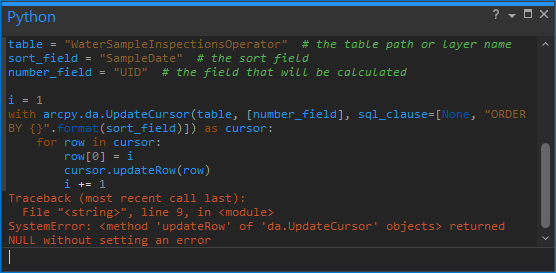

I also ran the Python to see what results I would get and received this
Again thank you for your support Sir.
