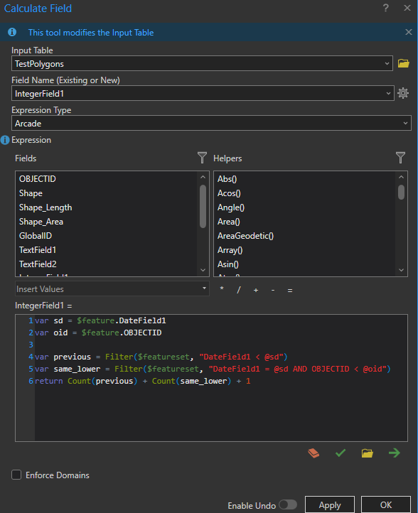

JohannesLindner
MVP Alum
var sd = $feature.DateField1
var oid = $feature.OBJECTID
var previous = Filter($featureset, "DateField1 < @SD")
var same_lower = Filter($featureset, "DateField1 = @SD AND OBJECTID < @oid")
return Count(previous) + Count(same_lower) + 1
Have a great day!

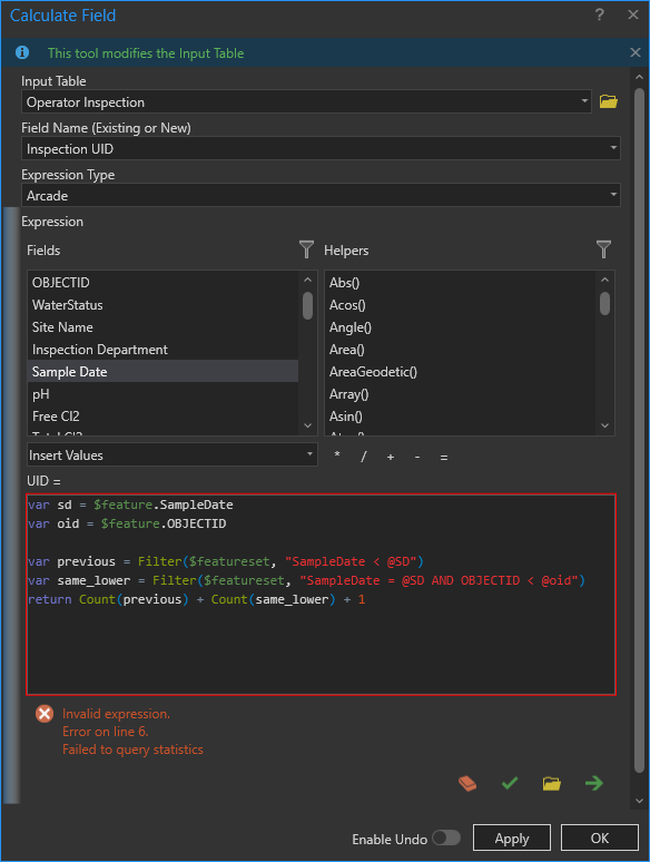

BrianHumphries1
Good Morning,
Running this Code produced this error... See Below
var sd = $feature.SampleDate
var previous = Filter($featureset, "SampleDate < @SD")
var same_lower = Filter($featureset, "SampleDate = @SD AND OBJECTID < @oid")
Calculate Field
Parameters
Input Table Operator Inspection
Field Name (Existing or New) UID
Expression
Expression Type ARCADE
Code Block
Updated Input Table Operator Inspection
Field Type TEXT
Enforce Domains NO_ENFORCE_DOMAINS
Messages
Start Time: Thursday, May 25, 2023 8:58:46 AM
ERROR 002717: Invalid Arcade expression, Arcade error: Failed to query statistics, Script line: 6
Failed to execute (CalculateField).
Failed at Thursday, May 25, 2023 8:58:46 AM (Elapsed Time: 0.50 seconds)

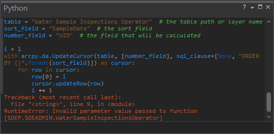

JohannesLindner
MVP Alum
I have no idea why this is happening...
Try doing it with a Python script instead (not in the Field Calculator, in the Python Window):
table = "TestPolygons"  # the table path or layer name
sort_field = "DateField1"  # the sort field
number_field = "IntegerField1"  # the field that will be calculated
i = 1
with arcpy.da.UpdateCursor(table, [number_field], sql_clause=[None, "ORDER BY {}".format(sort_field)]) as cursor:
    for row in cursor:
        row[0] = i
        cursor.updateRow(row)
        i += 1
Have a great day!
Johannes
BrianHumphries1
Hello Johannes,
I ran as python and received a RuntimeError..,
table = "Water Sample Inspections Operator" # the table path or layer name
sort_field = "SampleDate" # the sort field
number_field = "UID" # the field that will be calculated
i = 1
for row in cursor:
row[0] = i
i += 1
File "<string>", line 9, in <module>
RuntimeError: Invalid parameter value passed to function [SDEP.SDEADMIN.WaterSampleInspectionsOperator]
