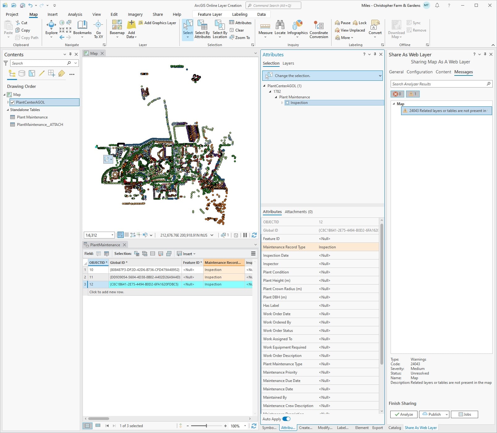

I am trying to publish a web layer that has a relationship class created in ArcGIS Pro, but I keep getting a warning that the related table is not in the map. The table is in the map, and I can add new records to the table using the Attributes pane.
I am not sure what I am doing wrong. I have remade the features and tables twice now, updated Pro, recreated the relationship class, etc.
Any help would be greatly appreciated.
- Miles

This appears to be BUG-000159111 - The Share As Web Layer tool returns the following warning message, "24043 Related layers or tables are not present in the map," when the related layers are in the map." and was fixed for the ArcGIS Pro 3.2 release.  What release of ArcGIS Pro are you using?
JBald
I have the same error and I am using the most current version of ArcGIS Pro.   the error occurs when layers are renamed in the content pane because of the warning.    If I do not change the names in the contents, then I do not get the relationship table error.

Thanks @MilesThompson for posting! Same exact thing is happening for me.
@Robert_LeClair I am using Pro version 3.2.1. My relationship class is Origin is the table and Destination is the feature class. Pro doesn't work well with that in other areas (pop-up configuration etc). So I wonder if this is also related to that issue?
**Edit - nope, nevermind! User error! Table was named what it was supposed to be but actually pointed at the wrong table source. Once I fixed that, no warnings! **
