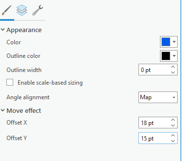

For the second question, you can apply a move effect to each symbol, but that won't change the leader line's location.
AlfredBaldenweck_1-1758894441459.pngAlfredBaldenweck_1-1758894441459.pngAlfredBaldenweck_2-1758894453281.pngAlfredBaldenweck_2-1758894453281.png
