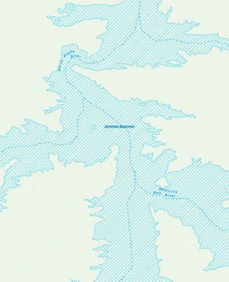

Hello everybody ! The masking tools with ArcGIS Pro are wonderful, but when we use labels with a masked layer, they remain displayed on the map. And we have to export them as annotations to get the result we need (and it doesn't facilitate our work).
So it could be useful to integrate the labels into the masking functions. Even if it's possible...

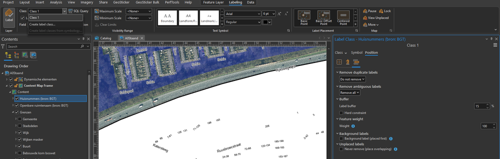

Curiously, this still does not work as expected in ArcGIS Pro 3.6.1.
I have applied masking to the layers showing street names and house numbers. And adjusted the Label Weight Ranking as suggesties a few years ago as one of the first comments by @WendyHarrison in 2021.
What am I doing wrong here?

Are they true feature labels or annotation? If annotation then you should be able to mask them like any other layer. If they are labels then I'm not sure why they aren't being blocked. Looks correct to me. Only suggestion is do you have the "Never remove" option enabled in that layers labelling properties?
Erwinvan_Veen1
Thank you @LindsayRaabe_FPCWA. Yes, I have only used labels. No annotations.
I did not check the 'never remove' option before. It is disabled (see the image below). Perhaps there is another setting that stands in the way of properly removing the labels. It is quite difficult to know which settings to set in which way, because there are so many. I will give it a go.
