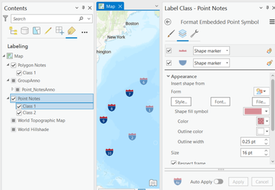

@WendyHarrison Other than converting to annotation, do you have any tips/suggestions for what would amount to muting a label, i.e., still visible, but UNDER a semi-transparent mask? See the example below:
Ideally, the road shields in the surrounding counties which are masked with a semi-transparent fill, would be just as their geometries are - still visible but placed UNDER the mask, thus muted in appearance.
WendyHarrison
@mhendo
another workaround would be to split the labels into two label classes with an sql query and then use transparency on the text symbol for the labels that fall under the mask
image below shows label class 1 with feature oid <= 6 and class 2 with feature oid > 6
label class 1 has transparent shields and class 2 has nontransparent shields.
