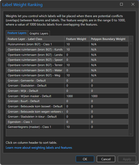

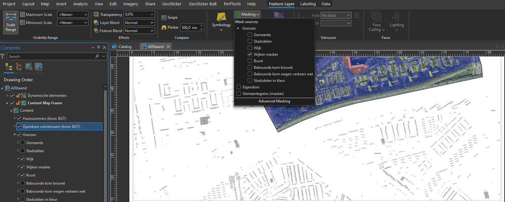

Erwinvan_Veen1
Curiously, this still does not work as expected in ArcGIS Pro 3.6.1.
I have applied masking to the layers showing street names and house numbers. And adjusted the Label Weight Ranking as suggesties a few years ago as one of the first comments by @WendyHarrison in 2021.
What am I doing wrong here?
