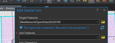

I appreciate this warning banner, and I'd appreciate it even more if it included a clear button right there by refresh. A lot of the time (maybe even most), I don't want to run my tools on a selection. I've added a clear button to my quick access, you can find it on the ribbon somewhere (map view only), and newer versions have a button in the bottom corner, but that only shows up in map view. If you're in a layout, your window's in the way, etc, you're out of luck. Even if you did have the button always visible like I do, a quick button right there would be super useful in many circumstances. Redundancy is not always bad.
Another solution might be to just have a switch to flip off running on the selection - retaining the selection, in case you were doing something else with it.

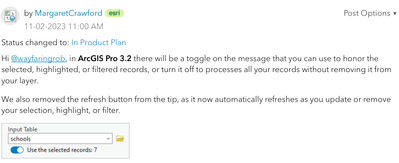

Here is the good news: what you suggested has already been implemented for the upcoming release. Hope you will get it soon.  🙂
MargaretCrawford
Status changed to: In Product Plan
Hi @wayfaringrob, in ArcGIS Pro 3.2 there will be a toggle on the message that you can use to honor the selected, highlighted, or filtered records, or turn it off to processes all your records without removing it from your layer.
We also removed the refresh button from the tip, as it now automatically refreshes as you update or remove your selection, highlight, or filter.

Regarding the wording, “Use the highlighted records: 4”:
Did Esri consider putting the word “only” in there?
  • Only use the highlighted records: 4”
  • ”Use the highlighted records only: 4”
Or did you figure that was unnecessary? Just curious, not suggesting one way or the other.
Bud
@MargaretCrawford
In ArcGIS Pro 3.2 there will be a toggle on the message that you can use to honor the selected, highlighted, or filtered records, or turn it off to processes all your records without removing it from your layer.
If the toggle were disabled (ALL records will be used), what kinds of filters would be ignored?
  1. Definition query
  2. Range
  3. Time
  4. Extents
  5. Join - Matching-only
What was the rationale for ignoring filters?
Is there a way to make it clearer that disabling the selection also disables the filter? Other than the explanation in the tooltip.
Did Esri consider providing separate toggles, one for the selection, and one for filtering (only available if the selection toggle is disabled)? The downside being added complexity.

MargaretCrawford
Attribute-based filters: time, range, and definition queries.
see: https://pro.arcgis.com/en/pro-app/latest/tool-reference/appendices/filtered-inputs-for-geoprocessing...
No, we didn't consider this as an alternative. Geoprocessing has had these rules about handling selections first then filters since ArcMap. We do not want to change this logic since many users may count on getting consistent behaviours.
Not that I am aware of, but I saw the idea you just posted. We will keep it open and see how people feel about the wording. Thank you!
