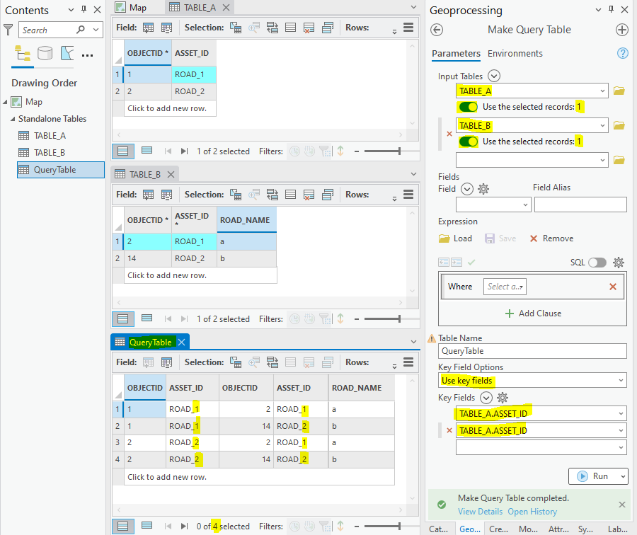

I wonder if the Use the highlighted records toggle should be removed from the Make Query Table tool.
BUG-000166125: ArcGIS Pro 3.2.2 - Make Query Table Tool joining all tables despite selected records
[I think "tables" in the bug title above is a typo. It should be "rows" or something like that.]
Source: Esri Support Case 03574486 How to join using Make Query Table?

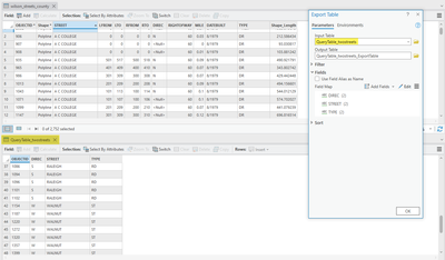

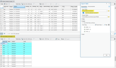

Bud
@MargaretCrawford

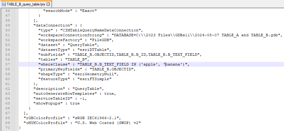

Interestingly, if there is a selection in a Make Query Table that has a SQL expression, and I disable the selection toggle in a tool like Export Features, the tool doesn't ignore the SQL expression in the Make Query Table layer. I guess that's because the SQL expression in Make Query Table layers is hidden/embedded within the layer; it isn't a definition query.
https://community.esri.com/t5/arcgis-pro-ideas/consistent-visible-sql-expressions-and-query/idc-p/13...
I'm not suggesting that's good or bad. Although, from a purist standpoint, I would have considered an SQL expression in a Make Query Table layer to be an attribute filter. But it isn't being treated as an attribute filter in this case.

MargaretCrawford
Hi @Bud,
The toggle on the  tool dialog will not appear when you use a query table as an input,
unless there is a selection, highlight or filter applied.
So, for query tables, the query will always be honored by the tool even if you turn off the toggle.
We also discussed this in more detail here: https://community.esri.com/t5/arcgis-pro-ideas/gp-tools-ignore-selection-but-honor-definition/idc-p/...
