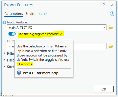

There's a new toggle in geoprocessing tools that lets us choose to use the highlighted/selected records (toggle enabled) or all records (toggle disabled).
Disabling that toggle means the tool will
 ignore filters on the layer (definition query, time filter, range filter [and a selection layer's "selection definition set"]).
I would like to have the option of ignoring the selection, but honoring filters (like a definition query). I have standard definition queries that I apply to almost all FCs/tables, such as STATUS=ACTIVE. It wouldn't make sense to ignore those definition queries in GP tools just because I have a selection.
The enhanced functionality could look something like this:  If the selection toggle is disabled, then provide an option to honor filters: yes/no.
Related: Original Idea - "The input has a selection." - slap a clear button in there!

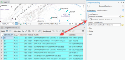

I want to address some concerns about the selection, highlight and filter toggle button. Turning the toggle off will not remove your selections, highlights, or filters. Rather, it gives you the option to ignore them so you can process all records when you run the tool.
In the image below the selection was not removed from the layer even though the toggle is off:

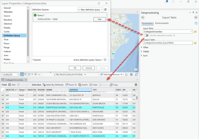

Similarily, when you have a layer with a definition query and a selection applied, turning off the toggle will cause the tool to use all records in the table. Turning the toggle off will not remove the definition query from your layer.  If you would like to run a tool with the definiton query but no selection, you will have to remove the selection from the layer, rather than using the toggle button.
(In this image: the layer has a definition query and a selection. I can turn the toggle off in the tool, and they will still be present and active on the layer).
