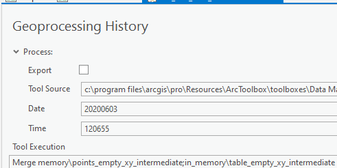

It looks like in the metadata's Geoprocessing History, one could individually choose to export (or not) processes.

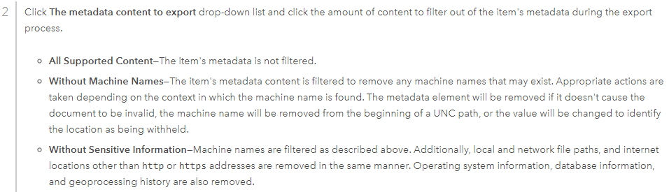

If the main use case is when sharing exported metadata, see Export metadata to a standard format—ArcGIS Pro | Documentation

On the second point, based on testing reported by Esri Technical Support, exporting the metadata from Pro without Sensitive Information or Machine Names and then importing it back into Pro will not remove this information from the source metadata. We need to redact the embedded metadata.
Please let me know if you find either of these not to be the case, or have additional thoughts on point #2.
