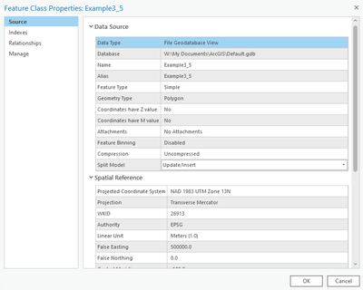

AlfredBaldenweck
Hi, I created a view in a file gdb and I can't see the definition after the fact. Are there plans to add this functionality to file GDBs?
I can see the definition in mobile GDBs and Enterprise GDBs, but not in a file GDB. (Pro 2.9.5)
KoryKramer
@AlfredBaldenweck Unfortunately there was a regression. See https://community.esri.com/t5/arcgis-pro-ideas/view-sql-definition-of-fgdb-database-views/idi-p/1238...
I see you're still on 2.9.5. The bug on the support site indicates that it was patched in 2.9.8 so if you install the latest 2.9.x patch (10 at this point I believe), this should be resolved: https://support.esri.com/en-us/bug/a-view-definition-is-not-displayed-for-file-geodatabase-bug-00015...
