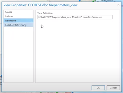

For enterprise geodatabases, we're able to see the SQL definition of the view in the view's properties in Catalog:

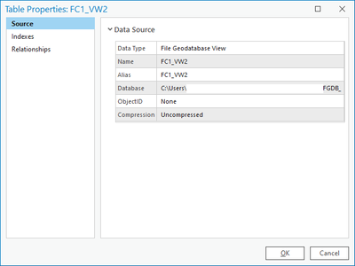

But that doesn't seem to work for file geodatabase views. There isn't a Definition section in the view's properties:

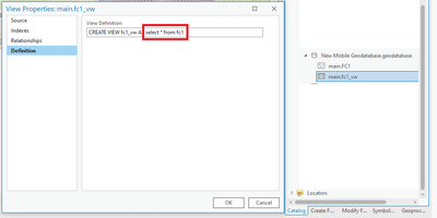

For what it's worth, it's possible to view the SQL of a mobile geodatabase. So the FGDB is the exception to the rule.

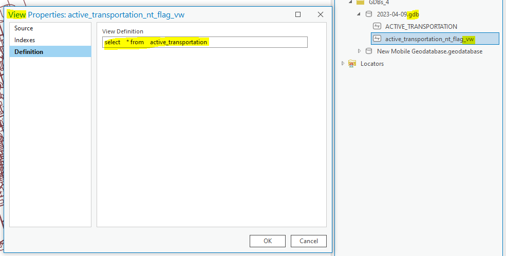

Bud
This issue appears to be fixed in ArcGIS Pro 3.1.1 (and possibly earlier versions).
