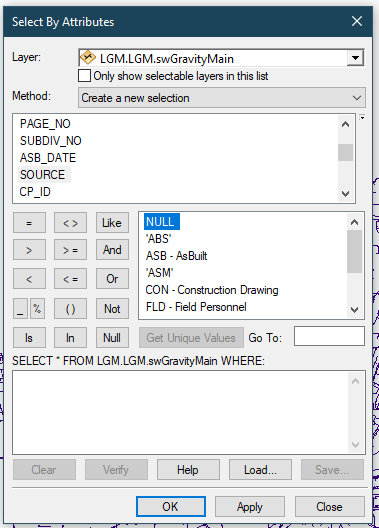

In ArcMap, when you Select by Attribute and get unique values it will show you ALL values in that field. Even ones that aren't in the domain. This is highly handy as it's a quick way to see if there is incorrect data. In the image below, you can see that ArcMap shows two values ('ABS' and 'ASM') that are in the data but not in the domain.
By comparison, Pro only shows you values that are in the domain.When looking at the list I would have no idea that those two values are in my data. And yes, I can build the SQL expression manually if I know the values are there, but what if I don't?
Having the Select by Attribute list ALL values not matter if they were in the domain or not was VERY helpful and I wish that Pro would follow ArcMap's example.

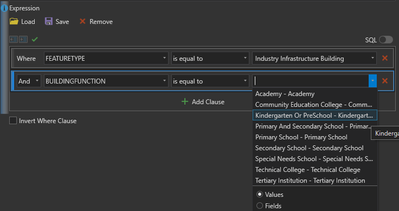

Thanks KoryKramer, not quite what I'm after but I have done some more research on my layer and found what is happening but not sure if it is something I'm doing wrong.  What I have is Building Areas and they are broken down into different subtypes such as education, emergency, health etc and under each of these subtypes is a domain of building functions.  when I try to do a select by attributes it only shows the domain values for the first subtype but I can't seem to get it to show the values for the other domain values.  Even when I select the option of a feature subtype, it still shows the first subtype (education) building function domain.

As they are in the one layer, when I try to do a select by attributes I could be looking to highlight the emergency and health buildings in the area and I have tried to do a select by feature type as emergency and then function by but it still only shows the educational options (again which is the first subtype).
I don't have many layers with this setup of multiple domains for subtypes and have managed to work around the select by attributes by using the SQL function and typing it in, but it would be easier if I could select the option from the drop down menu in the expression builder.  I know in ArcMap I used to click on list all values and it would show all of the values in that field (same as the initial post).

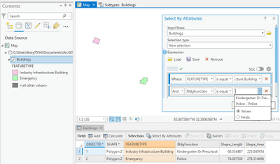

I set up something similar to what you have:
Below you can see that in my attribute table I have 1 feature from each subtype, so the BldgFunction field has 1 value from each different domain:
In the query builder dropdown, I see the available values to choose from, not just from a single domain.
In your attribute table, do you have values from multiple domains?  Is there a definition query set on the layer?  As far as I can tell, I am still not seeing what you are seeing, so this will take further troubleshooting.

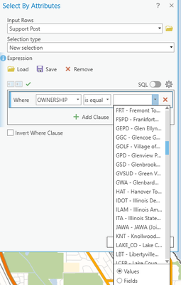

I just wanted to upvote this topic as the Get Unique Values function was a really simple way to identify when someone Field Calculated a value that does not match a valid domain entry.  I'm still not seeing an alternative workflow in ArcPro for this common data quality issue.  In 2.8.3, using the select by attributes query, I can only select valid domain values and it ignores values that exist in the data that do not meet the domain requirement.  In my example below the "Village of Itasca and Village of Schaumburg" were added incorrectly.  Visually it is super straightforward to spot them in ArcMap since they don't have the format of [Code - Description]
ArcPro 2.8.3
