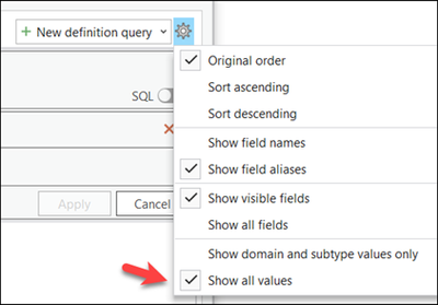

This Idea has been implemented in ArcGIS Pro 3.2. Please see the What's New documentation for more new features in Pro 3.2.
The Your Ideas in ArcGIS Pro 3.2 blog and video have been posted to the Esri Community blog. You can take a look at these to see your idea and all others that were implemented in this release of ArcGIS Pro.
KarenShaw
TanuHoque (Esri),
Thanks for update on it being implemented. Your screenshot was very helpful on how select Show all values option.

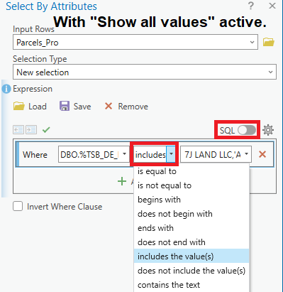

I've updated to ArcGIS Pro 3.2 . Now the Select by Attribute works better with the "includes the values(s)" Query (also Known as "IN" statements in SQL).
The radio button drop down list of values options works fine and Toggling between Query and SQL works well for the includes value(s) statements now.
Thanks for every Esri GIS Programmer who worked on this and resolved this issue! 😊
