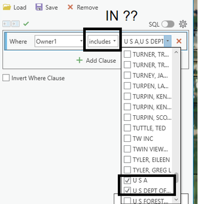

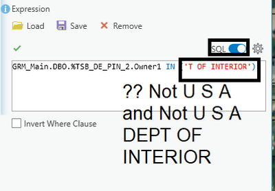

For example in my dataset, ownership could be US, or USA, U S A, or U S A DEPT OF INTERIOR.  In ArcMap I could easy find all name variations and select them all with the IN Operator.  In Pro, it a complex task of using the small drop down box (which is small), using includes statement (which is buggy when toggling to SQL) and trying to get all needed name variations.  I bring this up to show the complexity the task is in Pro (I am not so worried about the bug issue).

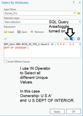

Example in Pro what Query should be: (I manually copied and pasted in U S A and US DEPT OF INTERIOR into SQL Query myself.

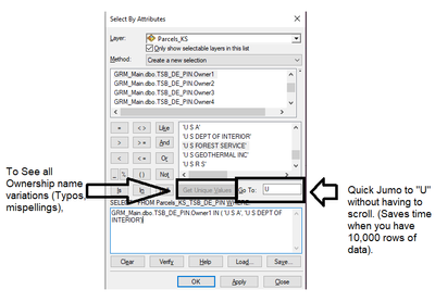

ArcMap Example (below) is so much simpler to do the same task. I added all ownership names by double clicking them into the SQL Query. This possible because the get Unique Values button exists and I can hand write in SQL queries on same window.
