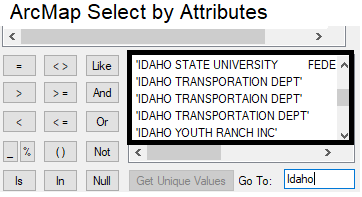

In ArcMap, when you Select by Attribute and get unique values it will show you ALL values in that field. Even ones that aren't in the domain. This is highly handy as it's a quick way to see if there is incorrect data. In the image below, you can see that ArcMap shows two values ('ABS' and 'ASM') that are in the data but not in the domain.

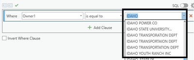

By comparison, Pro only shows you values that are in the domain.When looking at the list I would have no idea that those two values are in my data. And yes, I can build the SQL expression manually if I know the values are there, but what if I don't?
Having the Select by Attribute list ALL values not matter if they were in the domain or not was VERY helpful and I wish that Pro would follow ArcMap's example.

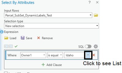

The Get Unique Values is very useful ability in Select by Attributes tool. When adding this feature back in, also Please add it as a LIST and Not as a drop down menu. In Pro, having to click on Arrow THEN looking at the list adds complexity.
In Pro
In Pro, clicking the Arrow then scrolling through a List format feels juggling several balls while standing on narrow ledge. The ArcMap way of showing a LIST right away just feels like throwing one ball up in the air and catching it. Must simpler!

Also, in the select by Attribute tool, it needs to have window that shows a list of possible attributes with a scroll bar. The Drop drop menu  in Pro adds complexity that is unneeded.
Having a window list (not drop down) and showing all unique values is very important part of my workflow. I hope this is added to future Pro release soon. While waiting for this, Does anyone know of another simple process for finding these unique values outside of the Select by Attributes tool?
