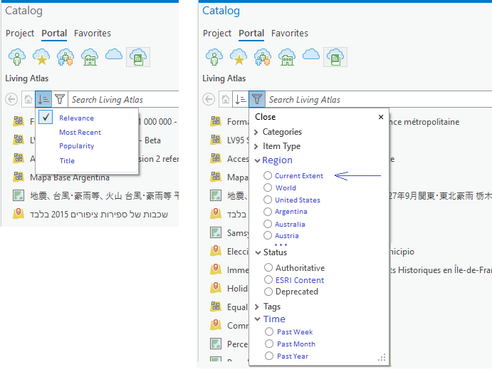

Add more filters to Living Atlas in ArcGIS Pro (as seen in blue in my mock-up).
The same filters and sort options which are on the Living Atlas website [https://livingatlas.arcgis.com/en/browse] could easily be made available in Pro.
In addition to the basic filters, please add filter by Current Extent.

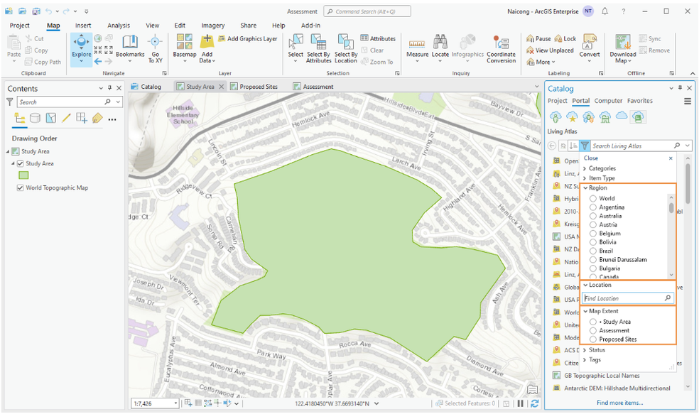

Hello @TimJohnston5 and everyone,
Thank you for your feedback.  With the release of ArcGIS Pro 3.2, we have implemented most of the suggestions in this Idea thread.  In the Catalog pane, Catalog view, and Add Data browse dialog box, if you current location is Living Atlas, you can filter the portal items by Region, by Location, and by Map Extent (besides by Categories, Item Type, Status, and Tags):
A note about filtering items by Map Extent: all the maps that are currently open in your project will appear under this filter, for you to choose.  The currently active map is marked.
For more details about using the Region, Location, and Map Extent filters in ArcGIS Pro, please see ArcGIS Pro documentation on "Search the active portal" (https://pro.arcgis.com/en/pro-app/latest/help/projects/search-portal-items.htm#ESRI_SECTION2_1EDA289...), section "Use spatial filters".

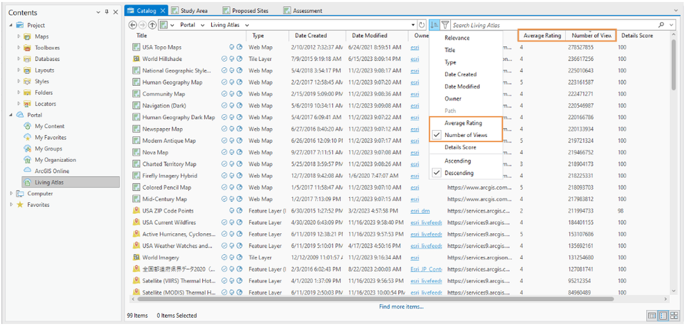

About the suggestion on the sorting option "Popularity", again, ArcGIS Online does not have this option per se, and neither does Pro. However there are more specific sorting options related to the concept of "popularity" - Average Rating, and Number of Views, which are the properties that you can sort on in the Catalog view and browse dialogs:
For more information on using these sort options, please see https://pro.arcgis.com/en/pro-app/latest/help/projects/use-catalog-views.htm.
