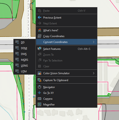

Does anyone have a link to an add-in for ArcGIS Pro 3x for a tool that will open Google Maps when you click on a location in your Pro map window?

Sean_Wray
@VenessaMcCracken  - right click on your map (see below) - then go to google maps and paste the result in the search.

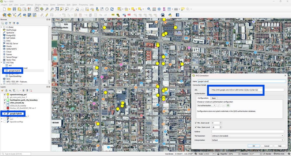

hoogw
Hi Guys , in 2025 I tried all of above googe map link is no longer working .
So you will need to use new google link
URL: http://mt0.google.com/vt/lyrs=y&hl=en&x={x}&y={y}&z={z}
URL: http://mt0.google.com/vt/lyrs=m&hl=en&x={x}&y={y}&z={z}
URL: http://mt0.google.com/vt/lyrs=p&hl=en&x={x}&y={y}&z={z}
NAME: GE Altered roadmap
URL: http://mt0.google.com/vt/lyrs=r&hl=en&x={x}&y={y}&z={z}
NAME: GE Satellite only
URL: http://mt0.google.com/vt/lyrs=s&hl=en&x={x}&y={y}&z={z}
NAME: GE Terrain only
URL: http://mt0.google.com/vt/lyrs=t&hl=en&x={x}&y={y}&z={z}
see my google map loaded with yellow point shape file
hoogw
install quick map service plugin, I can quickly add all google maps
