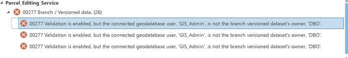

I have a parcel fabric that was in a file based gdb.  I have been able to get the data successfully transferred to SQL, and am trying to set up the feature service.  I created a branch version to my connection to the fabric, but when I publish the feature service according to these instructions (https://pro.arcgis.com/en/pro-app/latest/help/data/parcel-editing/workflow-publishpf.htm) , I run into an error.
I have no idea how to change the owner of the branch version to match with my connection.
Please help!

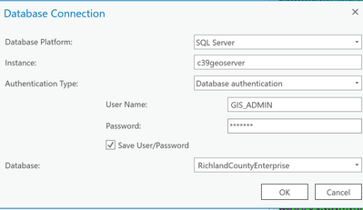

Double check you are logged into the .sde connection file as the "gis_admin" user.  It sounds to me the database connection properties are pointing to a user other than the owner of the data.
For example I have a fabric owned by "GIS".  To publish this fabric, I would need to log in as the GIS user to the database connection.
Let me know if that helps or if you have any more questions.
Ken
Syvertson
I am signed in as GIS_Admin.

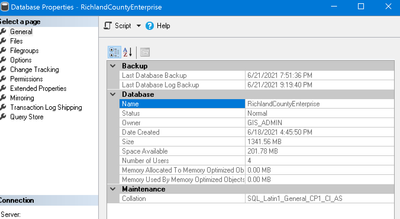

And in SQL, GIS Admin is the Owner:
When I create the connection to the database, the branch version is automatically assigned to DBO, I can't seem to change that.  I just need to figure out how to change the DBO schema ownership to GIS_Admin, I think??

Yes.  GIS_ADMIN has sysadmin permissions.  I changed the database owner in SQL Server to another user that was created just for this purpose.   I changed the connection properties to this new user and I re-added all the layers to the map.  Still had the same problems when trying to publish.
