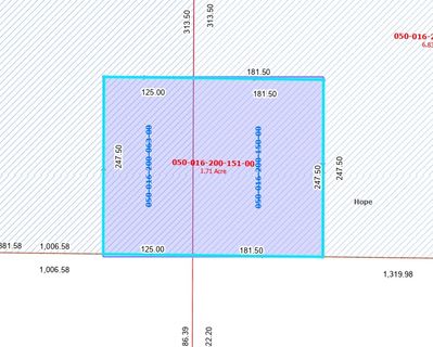

Screenshots might be helpful to see if there's something particular going in in this case.
Do all the lines remain current? It ought to retire the line that previously separated the parent parcels, while retaining the boundaries defining the exterior of the merged child parcel. Unless a record is re-defining the bearing/distance values, it makes sense to keep them, as the merge record is not "creating" the exterior boundaries.

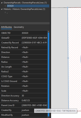

 Yes all of the lines on the exterior of the parcels remain current and the line in the middle is set to historic, which I know is supposed to happen. My issue is with the north and south boundaries of the new parcel in the screenshot. I would like to merge the two segments to have a line with new COGO measurements while the segments get set to historic for the parent parcels. When I do an identify after merging the two line segments (into an existing feature), it shows the merged line in the historic and current layer.

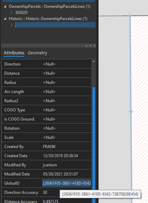

Oh, you shouldn't merge into an existing feature, as that will modify one of the input features and delete the other. When you're working with individual lines, you often need to use the "Set Historic" tool manually. In this case, you'd need to merge to a new feature, then set the input features as historic.
Copy Lines To
Alternately, I prefer to use Copy Lines To whenever possible. When you use the tool against parcel features, it will automatically retire the parcel and its lines, and will create copies of the lines in the active record. In that context, you'd absolutely want to merge your lines into an existing feature, as the existing lines have already been moved to "historic", and you'll be working exclusively with "fresh" features. Delete the inner boundary, delete one of the seeds, then build the record.
For the outer lines, not to worry. Note the global ID of the historic line, and the "parent line ID" attribute in the copy.
When you build the active record, if the new line has all the same geometry and attributes as its historic parent line, linked by that attribute, the new line is deleted and the parent line is restored. The fabric recognizes that if the new line is unchanged, the former line does not need to actually be retired.
But for those newly-merged lines, the change in geometry and attributes leads to the parent lines remaining historic.

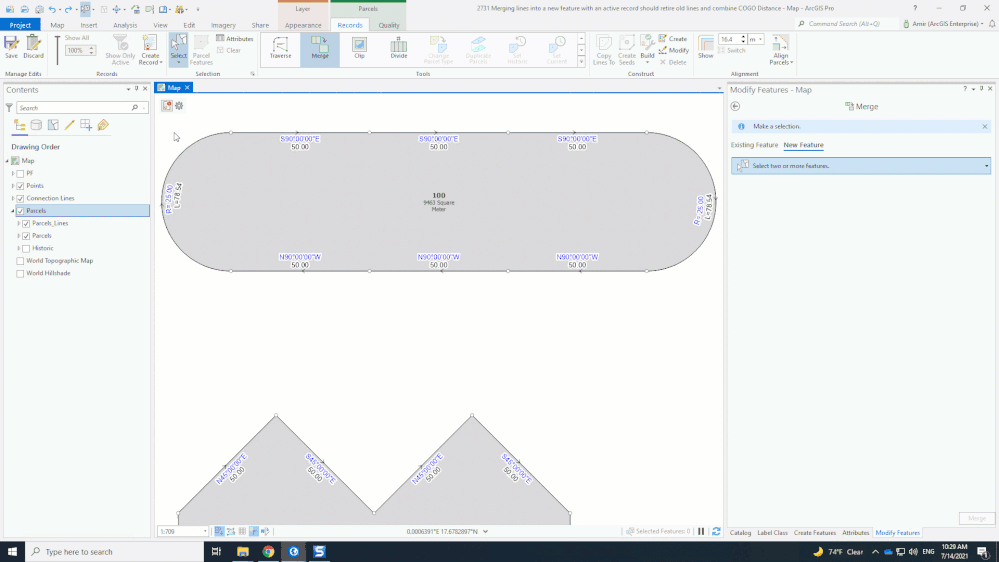

We plan to include the capability of merging lines in ArcGIS Pro 2.9. If you have an Active Record and the merged lines are collinear it will:
  1. Mark the parent lines as historic.
  2. Mark any point between the merged lines as historic.
  3. Combine the COGO values and preserve the direction if they are collinear.
  4. Show a preview of the COGO values before you press Merge.
Here is a sneak peek:
