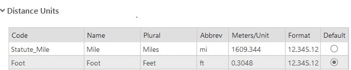

We are learning how to use traverse within the parcel fabric environment and really like that you can measure and use traverse both working at the same time.  Unfortunately, measure always has a default units of imperial when we open a project.
We followed the documented method to set the default units in options/units/distance units to set the default units to feet As follows:
Unfortunately, the units are still imperial.  Are we doing something wrong?
It appears that this was a issue some time ago and was fixed but I was not able to find it as a current bug.  I have tested this in both 2.8 and 2.6 so feel I must be doing something incorrectly.
