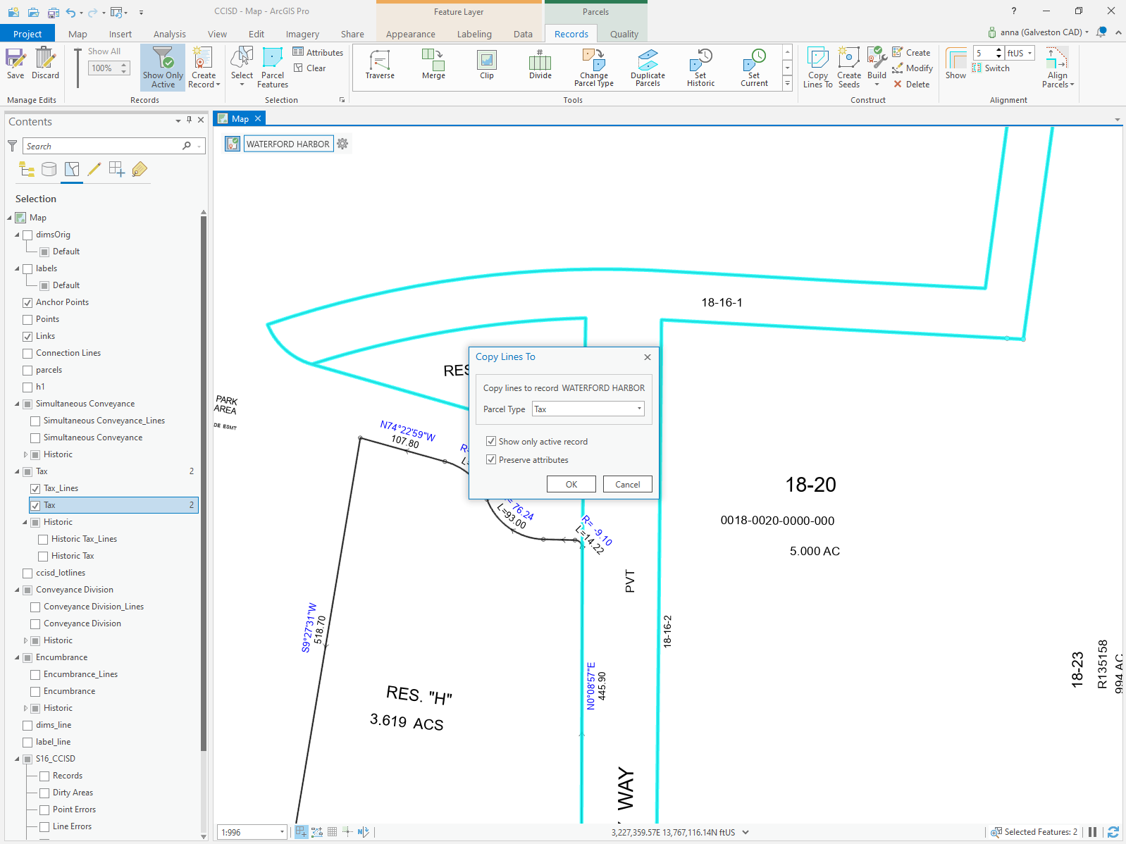

Has this happened to anyone else? I'm trying to utilize the Copy To Lines tool to generate my parcel lines from a polygon. I can't find anything in the documentation that would describe what went wrong.

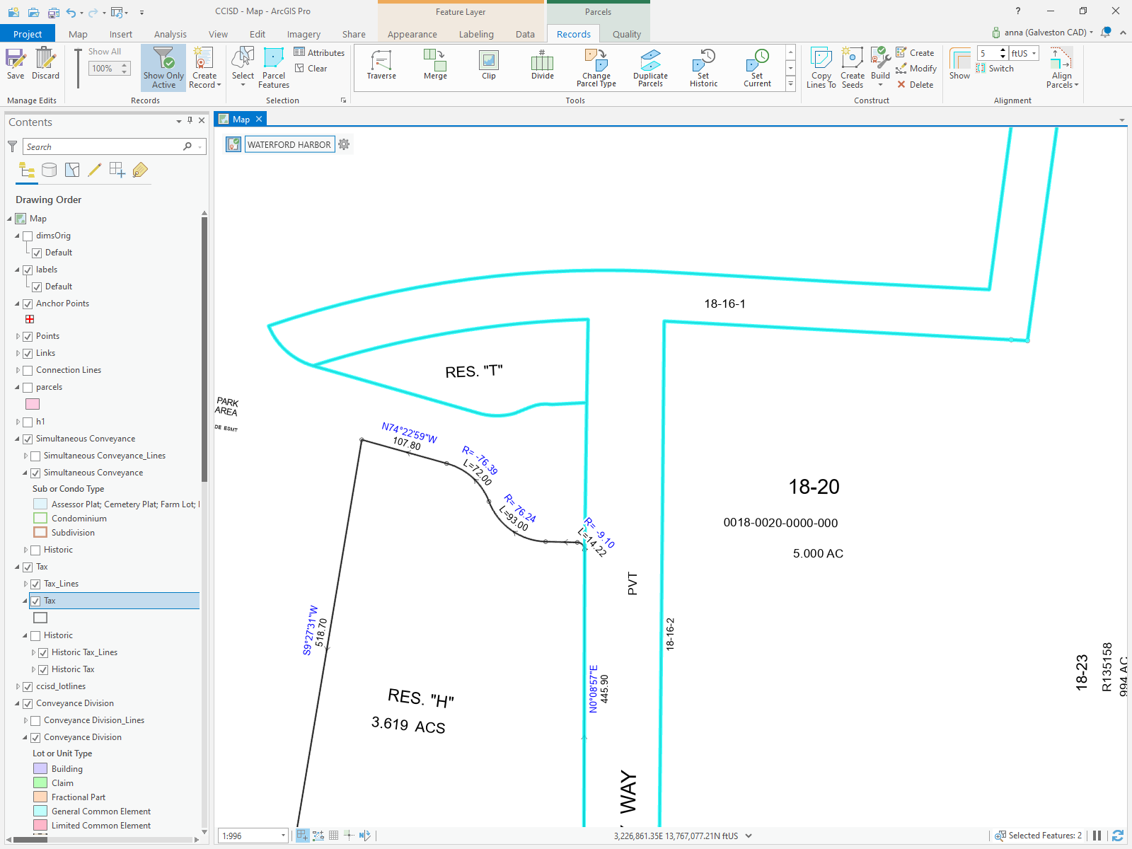

These are my polygons.
Copy Lines To dialog box. 

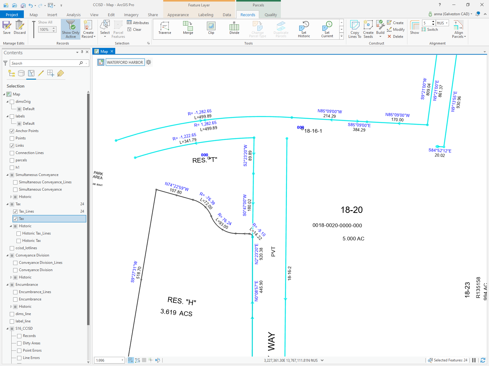

Final result? There are parcel seeds, but not all of the lines generated. No error messages or anything.

Copy Lines To makes its best guess on what a parcel's corresponding lines are, and it's based on the topological relationship between a parcel and a line. If a polygon boundary and a line feature are truly coincident, it should pick them up. Sometimes, it may even catch lines that you don't think it should have.
But if a line feature is off by more than your topology's cluster tolerance, it's going to treat it as separate, even if the two were created by the same record.
I would undo the copy lines, then perform a quick alignment between the polygon and the lines that are being missed, just to be 100% certain that everything is well-aligned. If the problem persists after aligning everything, you may have a bigger problem. But in my experience, this problem is almost always an issue of slight mis-alignment.

anna_garrett
That appears to have solved my problem! You're the best.

anna_garrett
That's the problem - the parcels in the first screenshot are all in the same record. I was working with the "Show Only Active" record filter applied.
