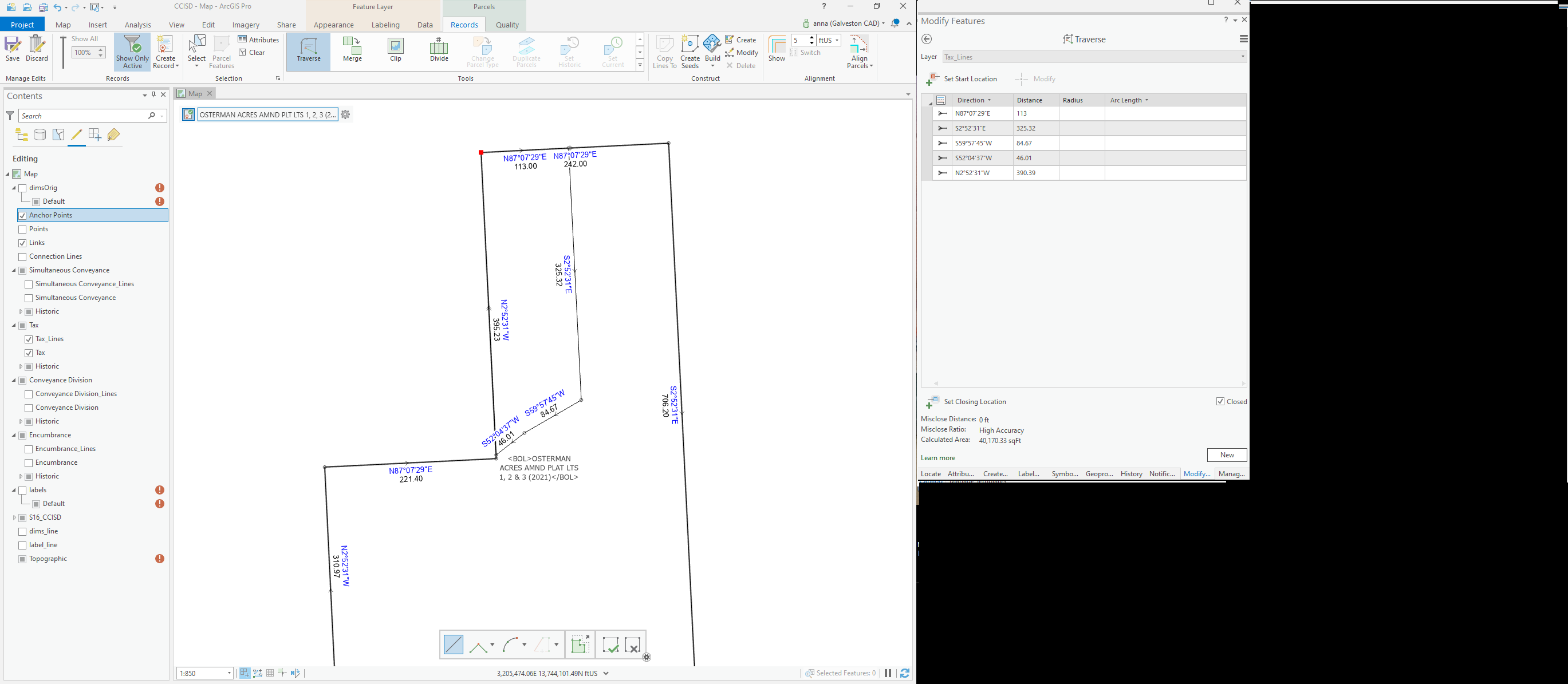

I'm trying to follow this workflow to generate my parcels: https://pro.arcgis.com/en/pro-app/latest/help/data/parcel-editing/buildparcelsfromlines.htm
This is a screenshot of my parcel lines:
I click on Create Seeds and nothing happens. Please note that the traverse window notes no misclose. The lines are assigned to the record. I have no idea what I'm doing wrong and I'm concerned for when I have to start entering new multi-lot subdivisions, because this is an extremely simple edit and the workflow as outlined isn't working. In the old parcel fabric this was a very quick edit - enter the lines for the subdivision and use construct from parent to generate the lots and tax parcels. What happened to that tool and workflow?  What am I doing wrong here?

I've had issues with this sort of thing as well. Sometimes there's a clear reason, but not always. In your first screenshot, it appears there already exists a parcel for this active record, and your traverse overlaps it?
It's important to note that the seeds are not a separate layer, just default symbology style for fabric layers. Without the seed-based symbology in place, a parcel seed is going to look like a regular parcel, albeit a circular one. Did you adjust the symbology for the parcels layer?
Is it possible there's a definition query in place filtering out seeds?
When I'm sort of stuck in similar situations, I'll often just create the seed myself. With a record active, the Parcel Seed feature template becomes available for parcel feature classes.
You can place the seed anywhere you like. Once placed, click Build to see if it successfully fills in your lines. If it does, you can shrug and move on, but if it doesn't, you need to take a closer look at the line features.

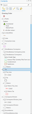

anna_garrett
My tax parcels are expanded in the contents pane and there is no seed layer.
edit: I moved on after this unsuccessful attempt to draw a new subdivision and successfully entered a metes and bounds description that generated a seed and from there a parcel. This inconsistency is troubling.
JeffWard
Honored Contributor
Anna,
Your screenshot is showing the "List by Editing" tab of your contents pane. Can you switch it to the "List by Drawing Order" pane and take another screenshot?

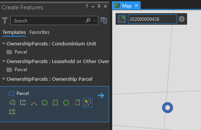

anna_garrett
The parcel that already exists is an attempt to recreate a workflow I used quite a bit in the old version of the parcel fabric, in that I'd use Construct from Parent on a new subdivision polygon and generate my lots and tax parcels from there. Super easy for smaller subdivisions like in the OP that only have two lots. My thought process was to copy the subdivision polygon to the tax layer, sketch the small lot with the Traverse tool, align it if needed, and then use the Clip tool to make the larger tax parcel.
I attempted to manually add a seed to the drawing in the OP, but when I build it a circle polygon is created over the manually placed seed. I'm going to start over and see if sketching out the lots at the same time will change anything.
