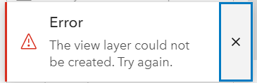

I'm attempting to upload a few small, pretty straightforward layers to ArcGIS Online, with the intent of creating a Feature Layer View of each one.  These views will have some of their attributes hidden, then be added to my organization's Open Data Portal.  The problem is, the Create View Layer process keeps failing with the extremely unhelpful message, "Error: Unable to add feature service definition", as seen in the attachment.
This is a workflow I've used many times before without issue, and indeed, it's only happening for two of the three layers in the current batch.  The third one worked exactly as expected, and is currently in the Open Data Portal.

I've run into "The view layer could not be created. Try again." as well when trying to copy items from one organization to another. There are two solutions. I've been able to do both.
1. I've been able to open the hosted feature layer in ArcPro export to file geodatabase, and republish as a brand new hosted feature layer. This is not feasible for any one with existing hosted feature layers across multiple maps.
2. I used overwriting an existing web layer with the data that was exported from the current hosted feature layer. This was to make sure it had the latest data. I even made sure even to have symbology setup as the same and "use the item description from the web layer". This worked for me when attempting to create the view after overwriting. When I selected "use item description from the map or layer" it did not work after publishing and attempting to create the view.

I receive the view layer could not be created. Try again. error when trying to create a view layer of a feature service that I have connected to QuickCapture and Workforce. Any idea why this might be happening? The ownership of the Workforce project was transferred over to me from one of the administrators in my organization so that I could integrate it with the other apps - wondering if this has something to do with the error and if there is a fix for it.
My feature service and the maps that contain it have empty descriptions in AGOL.

I am also receiving the same error in trying to create a view for hosted AGOL service with 10 layers. I have never had an issue prior to now on a view not working. The kicker on this is the past few days I have put a lot of time into updating metadata on these layers only to find out that the workaround is to remove metadata, this seems completely wrong.
Has anyone figured out any additional info? I really would rather not remove the metadata or have to remove then add in to the view, just seems like a bad workflow.

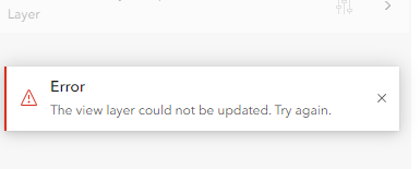

If the hosted view you are having issue updating is a part of the Survey123, this solution worked for me.
https://support.esri.com/en-us/knowledge-base/problem-survey-results-are-not-updated-in-arcgis-surve...
