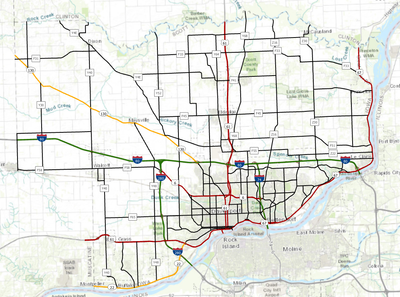

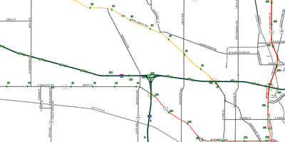

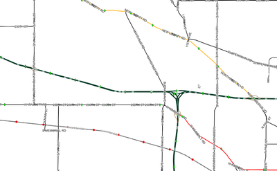

As far as web maps, I have tried to display this in both the new and classic viewer maps but each displays the former shields as text aligned along the road (shield is missing and horizontal label direction is now aligned).  I've also noticed that the standard label repeat/remove distance settings present in ArcPro are not preserved though I can't say whether that was the case or not before.  See screen shots below...the web map just doesn't look very good compared to the same in Pro.  I know I can tweak map label properties to improve on this (and again maybe I'm mis-remembering) but it seems like this was working better in the past when directly published from Pro.
ArcPro:
Web Map:

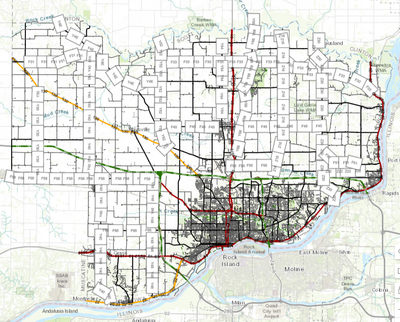

The original roads layer in my APRX file was imported from a layer file originally created from ArcMap, so I thought just in case there was/is something about that layer file source that was messing with things, I created a new APRX file, added the data fresh and rebuilt the symbology and labelling (I used the default shields available in the drop-down label context menu).  Then I republished both with and without the "Use symbols compatible with all clients" option checked.  Results were slightly different, including now successfully showing my square County Route shield labels (in New Map Viewer), but no other shields labeled (Interstate, State or U.S. Hwy), and the orientation and label density of the County Routes is messed up (shields no longer horizontal, and they're plastered all over the county route segments).  When opened in Classic Map Viewer, no shields (even County Routes) display.  See screen shots below:
View of rebuilt road layer in Pro:
View of rebuilt road layer in AGOL (New) Map Viewer after re-publishing (looks the same whether I have compatibility checked or not):
