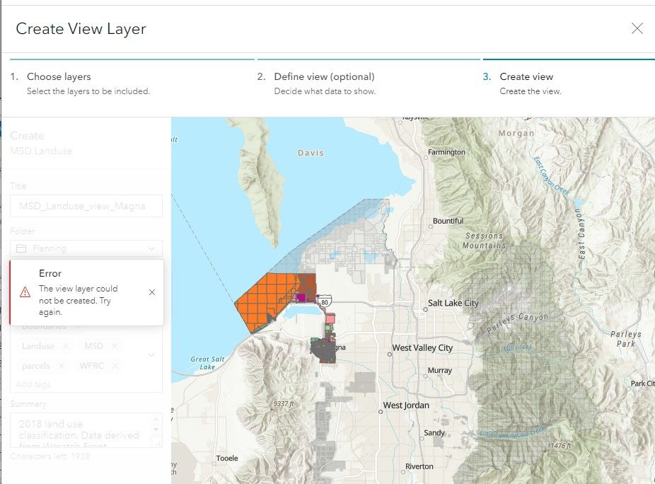

AlexRudowski
Hi @SaraHopkins,
I was getting a different error (screenshot) when trying to publish a hosted layer view, "The view layer could not be created. Try again." I followed the instructions in your post and I was able to successfully publish the view layer. Thank you!
After setting up the parameters for the view layer, I kept receiving this error. After removing the metadata and changing the metadata properties before publishing the layer, I was able to successfully create new layer views.After setting up the parameters for the view layer, I kept receiving this error. After removing the metadata and changing the metadata properties before publishing the layer, I was able to successfully create new layer views.
Ade_Bruijn
Hi, here also the error "The view layer could not be created. Try again."
Is there a way to delete the metadata without overwriting the hosted feature service?
