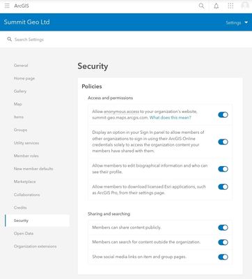

@sjeffs24  and have you enable public access for your organisation?
