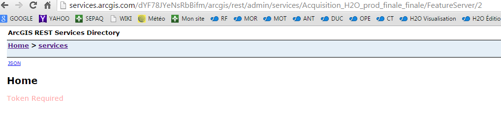

Hi,
it's a feature layer hosted on ArcGIS Online . I'm the owner of feature layer.
I want go to URl to edit somme domain. This is the error:
I add word "admin" between rest and service in the URL to modify the domain in the code.

Hi Catherine,
In order to access the admin of a hosted feature service, you must provide authentication in the form of a token.
To generate a token, you can copy one that is generated from signing into ArcGIS Online using a web debugger like fiddler or developer tools.
The Screenshot below shows how to get a token using fiddler:
Then construct your url to include the token:
http://services.arcgis.com/Wl7Y1m92PbjtJs5n/arcgis/admin/services/Yeti.FeatureServer?token=3Imzhcq47...

CatherineBouchard
Deactivated User
oh yes, thank you
