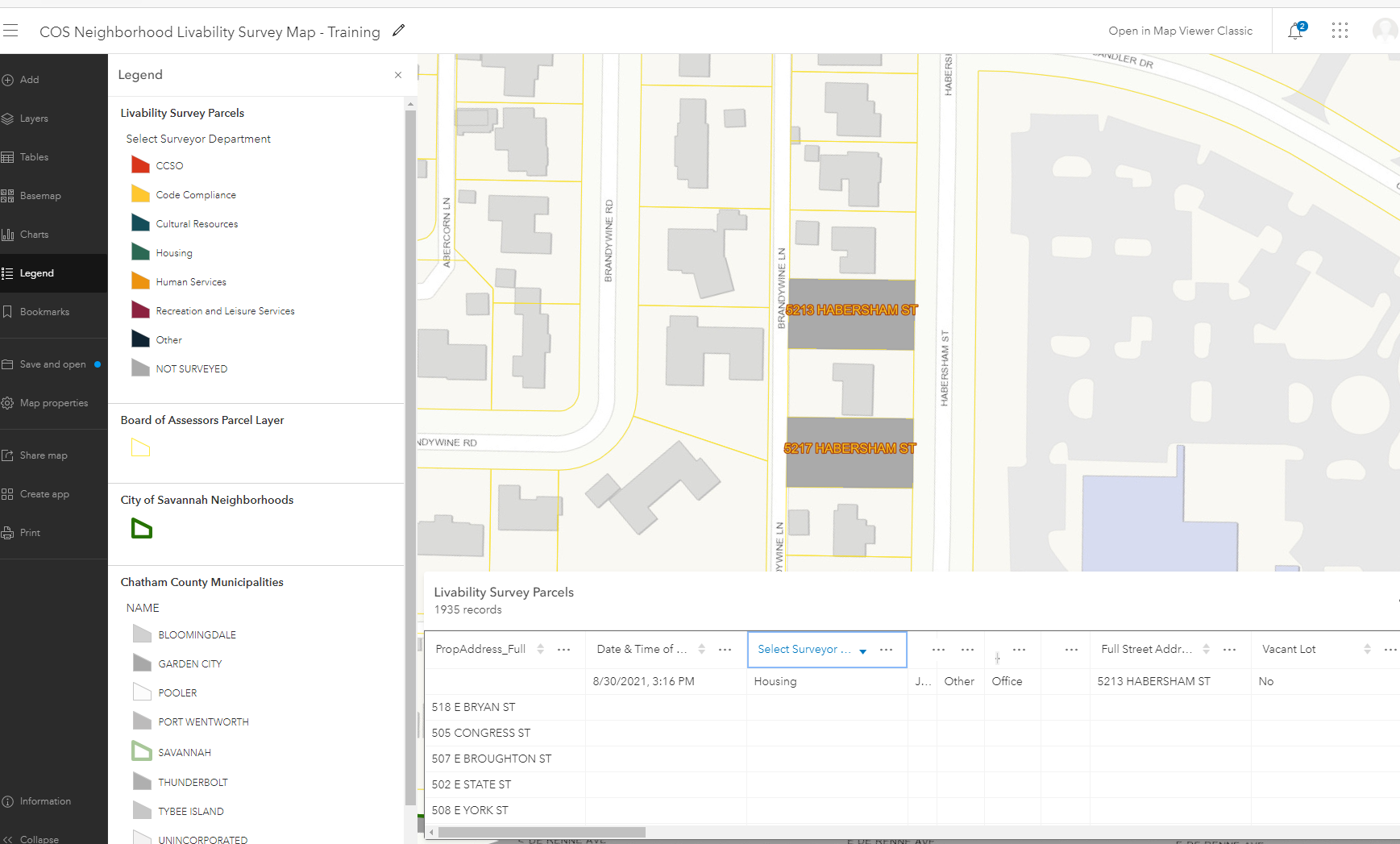

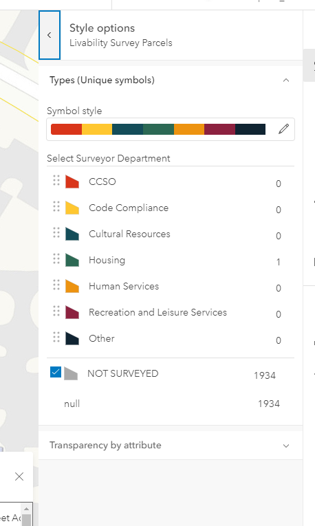

I believe I am trying to accomplish something pretty simple. I created a survey from a hosted feature service. I would like the symbology to change/update depending on the data submitted in the survey. Specifically, the field Survey_Dept (Alias: Select Surveyor Department), which has set options via a domain. In AGOL I have symbolized the field.
Testing the data entry and symbology, the colors are not changing when the department is selected: see screenshot. Address 5213 Habersham has the field filled out without a change in symbology - even though there is a 1 count next to Housing.
I renamed the last Other - being Null values as "NOT SURVEYED". Even when I designate a department in the field, the symbology doesn't change.
Do I really need to create a view, or should this work?

@JessicaJThompson Just as a quick troubleshoot. Have you tried setting this up in Map Viewer Classic to see if the behaviour is the same?

Have you tried making a List (domain) of the varies types?
It's been a while, I think I previously created a feature layer (to be edited by survey123) and a view layer with the colors set on it.
When I first set up the view layer, I had at least one of each type to get the symbology collect.  Then I went back and set the base feature layer to null

Yes, the list of departments in the field is via a domain, which is how I got the symbology (see first photo). However, this is just the symbology for the feature layer, and not a view.
I will also try the classic view, as suggested by @David_Brooks and see where that gets me.
