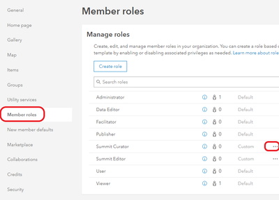

1. In the organisation settings > navigate to member roles:

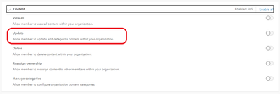

2. Create a custom role that matches your desired role for your users, but add in the following privilege.

@DuaneTreadon , only you as the content owner or an administrator can update portal items.
The solution to this is to create a custom editor or publisher role with an added privilege, to be able to modify other users' content:
