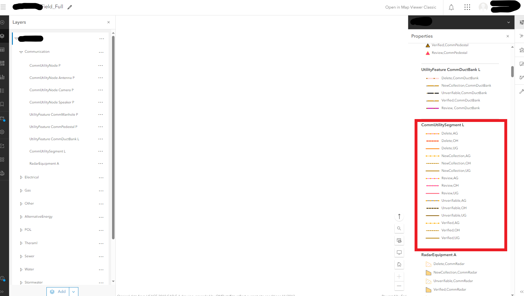

The following is what the symbology used to look like. The original map in AGOL is retaining the symbology.

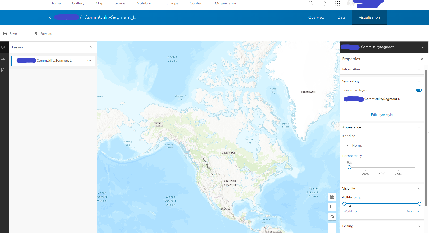

However, the visualization page for the same layer now only displays a single grey line.

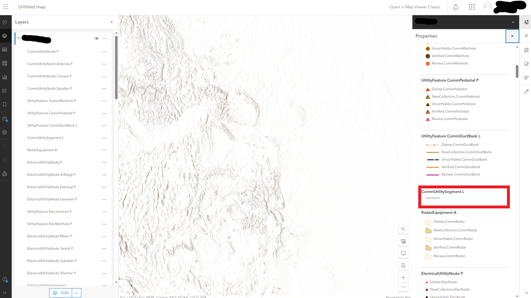

When adding the hosted feature layer to a new map it is also not honoring the symbology that was originally set.

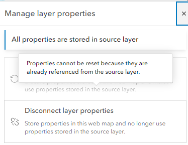

The source layer properties (symbology) were sent to AGOL in the hosted service, they were not created in AGOL so the original symbology should be the 'default' properties. The option to reset is not available because they are already referenced to source layer.
