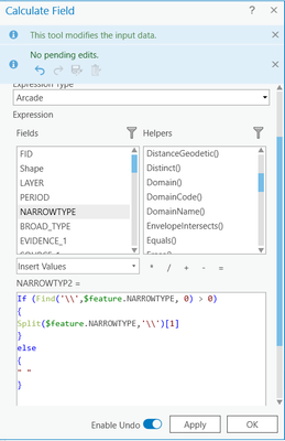

You can use this modified script for others (except Type1). The split function uses the same logic as before, i.e. [1] for Type2 and [2] for Type3.
If (Find('\\',$feature.NARROWTYPE, 0) > 0)
Split($feature.NARROWTYPE,'\\')[1]
else

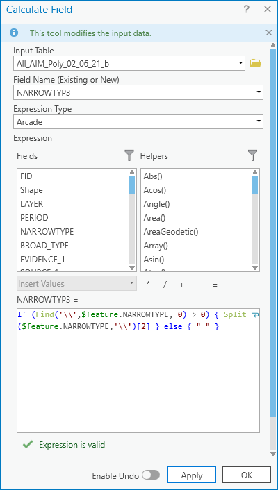

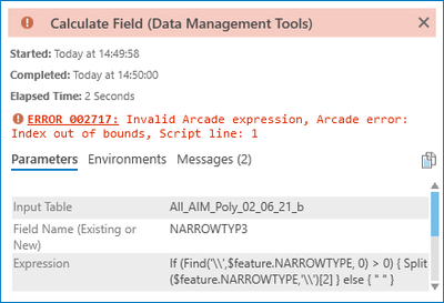

SimonCrutchley
Thanks for that, but I'm now very puzzled, as checking 'Verify' it seems to be valid
but on actually running it, I get an error?
How is that even possible?
