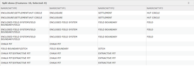

I have data in a concatenated list, created so that it is searchable in a single attribute, but I now discover that I need to make hyperlinks to the various entries
The easiest way to do this seems to be to split them into separate entries and then do a link to each unique entry, as there are far too many different combinations.
I currently have the concatenated fields separated by / e.g. the field currently called 'TYPE' has entries such as 'ENCLOSURE/FIELD/FIELD SYSTEM/SETTLEMENT' and I would like this to become a number of separate new fields TYPE1 = 'ENCLOSURE', TYPE2 = 'FIELD', TYPE3 = 'FIELD SYSTEM' etc
I attach a sample of a file where I did the split manually, to see if the process would produce the data in a form that I could then use in Portal, in a pop-up.
Hope you can help
Thanks

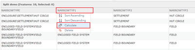

In ArcGIS Online (Map Viewer)
In ArcGIS Pro, use Calculate Field.

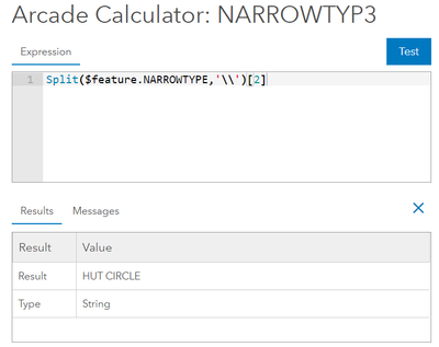

If you are sharing the data as a hosted feature layer in your ArcGIS Enterprise Portal/ ArcGIS Online, you can calculate field with the following Arcade expressions.
Type1:
Split($feature.NARROWTYPE,'\\')[0]
Type2:
Split($feature.NARROWTYPE,'\\')[1]
Type3:
Split($feature.NARROWTYPE,'\\')[2]
Edit: In the above sample, a few records missed "\" between ENCLOSED and FIELD SYSTEM, resulting in the Type1 field having value of "ENCLOSED FIELD SYSTEM". So desired substrings are separated by appropriate character (backslash in this case).

Since the question was posted in ArcGIS Online space, I provided solution in ArcGIS Online.

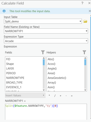

However, unfortunately this still doesn't help, as I don't know where to find the 'arcade calculator' or how to use it. Please could you give me a bit more detail?
Thanks
SimonCrutchley
Right, so I run it with [0] for the first entry. [1] for the second etc?
JayantaPoddar
MVP Alum
That's right. Choose "Arcade" as the expression type in Calculate Field in ArcGIS Pro.

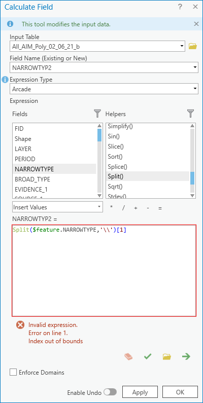

SimonCrutchley
Oops 🤔. It works for the first one, but the second gives me an error. I think I've copied what you wrote, but may have something wrong? Sorry
