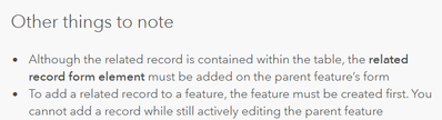

In my Forms I see the new 'Related records' element at the bottom. Unfortunately, when I expand the arrow down, I see "No related records available. Create new related records in ArcGIS Pro'.

Alright, from taking a look at the service you sent me @AndreaB_ you actually have relationship configured where the table is the parent and the feature is the child.
Currently this is not supported in AGOL, but may be something we consider adding support for in the future. I would suggest swapping the order of the relationship so it goes from feature - table. Thanks!

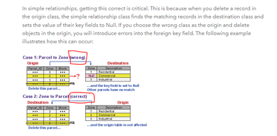

Yeah, so in a simple relationship the table record will remain but I should have said -  the foreign key will be changed to Null, introducing errors into the foreign key field. Understandably more of a problem with 1:M not so much in a 1:1, but still. I tested it with my data and a table record with the foreign key field changed to Null wouldn't help much if you were trying to tie it back to your data for some reason. That Esri documentation on this was helpful - https://pro.arcgis.com/en/pro-app/3.1/help/data/relationships/relationship-class-properties.htm

Thanks for figuring that out. I think we have our geodatabase relationship set up table as parent and feature as child to preserve the table records in case the feature is deleted - as described in this best practice help documentation. https://pro.arcgis.com/en/pro-app/3.1/help/data/relationships/relationship-class-properties.htm
