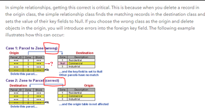

This idea is for Map Viewer Forms in AGOL (hosted data) to support a table-to-feature relationship (where the table is the parent (origin) and the feature is the child (destination)). This is considered a better practice in this documentation: https://pro.arcgis.com/en/pro-app/3.1/help/data/relationships/relationship-class-properties.htm to preserve the table records foreign key field in case the feature is deleted.
