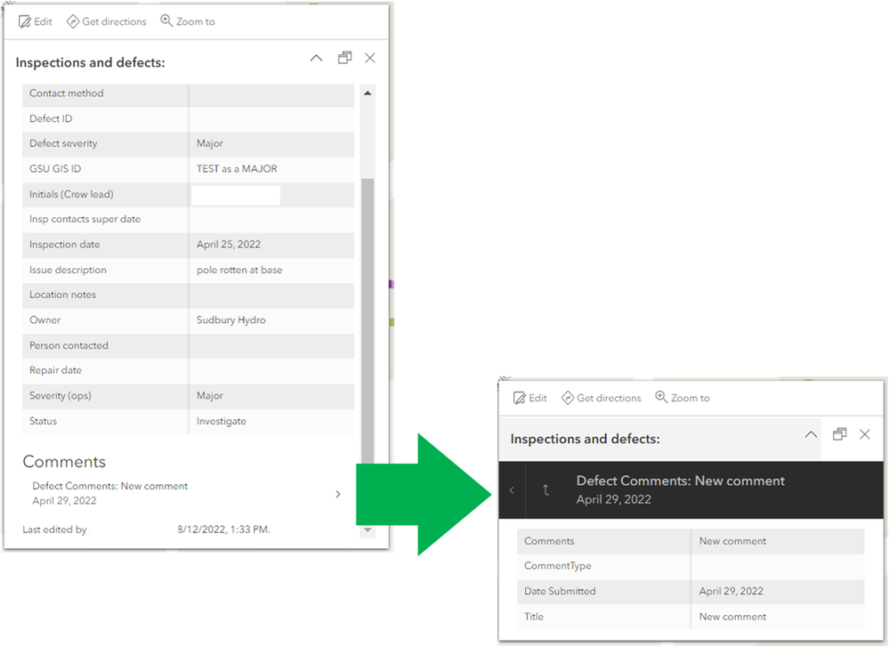

Thanks Esri for fixing it in Map Viewer. It's exactly what I wanted. We've had a related comments table that worked in Field Maps but had no way to show it. Now we can and it opens the door to more.... only if this works with Instant Apps, WxB, etc. I assume it does as it lives in the pop-up. Will test this next.
Anyhow, here's what I was hoping for and you delivered:
