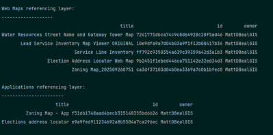

This partially worked for me! I wasn't able to get any returns for Applications but it worked for Web Maps. Completely unsure as to why. Either way the web map part was helpful
MDB_GIS
Odd. It should output a table that looks like this in the console:
There are a couple of things you can try. If you change the ITEM_TYPES variable to 'ITEM_TYPES = ["*"]', it will scan ALL items in your organization. Granted, it will take a good bit longer, but it will scan everything.
Another option is to run the script below. This will basically scan the target organization and list all items with it, as well as what their "ITEM_TYPE" is. You can then use that to fill out the "ITEM_TYPE" variable in the original script. It will also output an Excel file named "AGOL_Item_Types.csv" to your default directory. Hope this helps! Let me know if I can help in any way!

Excellent approach. Worked like a champ in my organization portal. Output exactly as you describe. Thanks!
