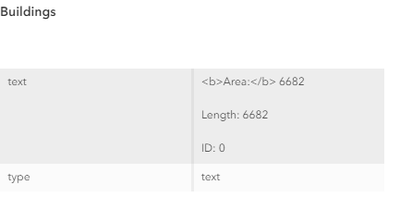

@KenBuja  the
 <b. </b>
formatting is not working any clues?
Whereas I would like the input to look to something like this:
Area: 6682
Lentgh: 6682

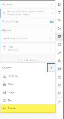

Are you putting this in Arcade element?
Ed_
by MVP Regular Contributor
Happy Friday Ken, so, I should put the entire code in Arcade element and not in expressions?
Question | Analyze | Visualize
KenBuja
MVP Esteemed Contributor
If you want to include HTML code, you'll have to use an Arcade element.

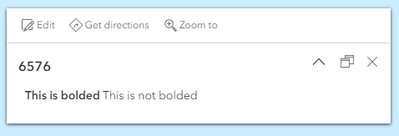

You could do a combination of text boxes and Arcade elements. The only drawback is you'll have a space between them. You can use the text box with expressions if you want to use the same HTML formatting for everything in an expression. If you want to have an expression to have different HTML formats in the same output, you'd have to use an Arcade element.

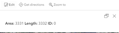

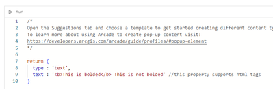

So Ken, I was able to get the text bolded as shown below:
But the attributes are not appearing in the next line. I also tried using /n but that did not work either.
Code for that:

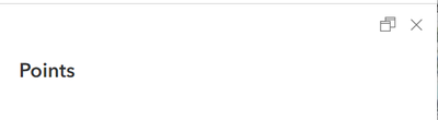

Also you will notice in another code below that I have tried to add two headings  one before the attributes and the another heading for the next layer's attributes. But, for some reason the output only shows the Points heading and nothing else.
Code for that:
// Create a variable that the FeatureSet of intersecting feature attributes
var building = FeatureSetByName($map, "BuildingFootprints_Clip")
var intersectLayer = Intersects(building, $feature)
var popup;
for (var f in intersectLayer){
  var popup = `<b>Area:</b> ${f.AREAFT}
  <b>Length:</b> ${f.LENFT}
  <b>ID:</b> ${f.ID}
return {
  type : 'text',
  text : '<h2>Building</h2>',
  type : 'text',
  text : popup,
  type : 'text',
  text : '<h2>Points</h2>',
// Now bring in the attributes from the next intersected layer with Parcel
I know I can use the the Text box  to add the headings but like you said then there would be a space between the text box heading and the Arcade Element which may or may not be ideal.

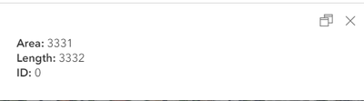

Ken, I got the line breaks fixed by adding <br> next to each attribute but I am still stuck with adding the headings. Also as you can see the line breaks don't look ideal as the line breaks are too closely spaced. And I am not sure how to increase/adjust the line spacing.
<b>Area:</b> ${f.AREAFT} <br>
