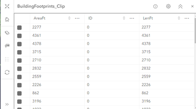

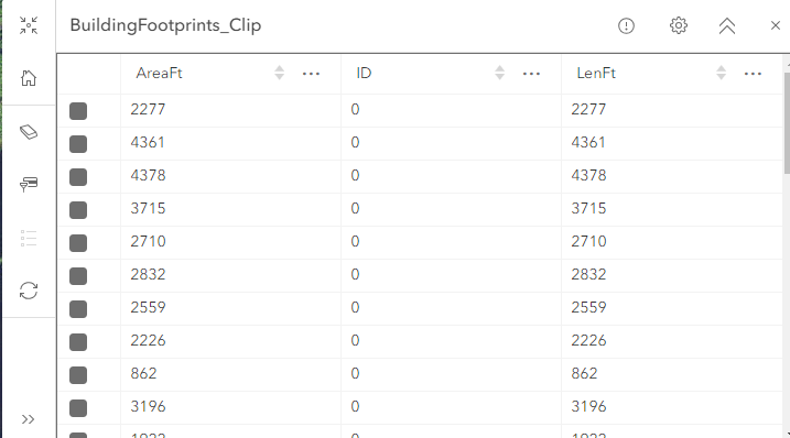

Attributes of interest from the building layer:
Code:
