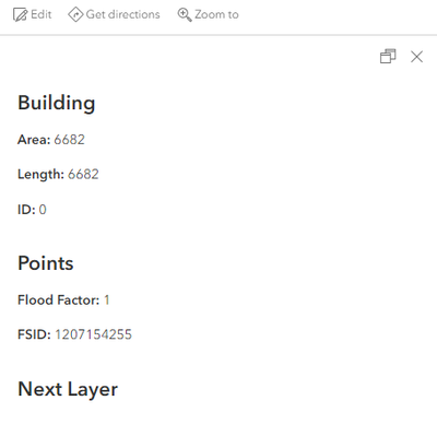

Hi Ken, I was able to work out the code a  bit further. It's interesting to note that I can keep on using the `popup` variable. Looking quite nice so far, thank you so much for all your help and especially your quick responses. I will let you know if I am stuck again.
Have a wonderful week 🙂
Working code so far:

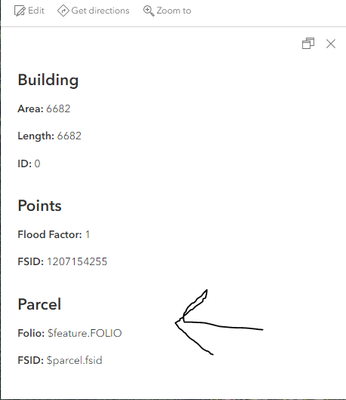

Hi Ken, another question please, so now I want to add the attributes from the parcel layer that surrounds the other layers. When the user clicks on it the popup will appear. Hence this layer does not need the intersect function.
But my code below is not working as shown in the screenshot.
I did try using a for loop but that returns each and every parcel's selected attributes  which is not what I want.
Code for parcel attributes:

Current output:

KenBuja
MVP Esteemed Contributor
When using template literals, you have to surround an expression with a dollar sign and curly braces, otherwise it's interpreted as just text.
popup += `<b>Folio:</b>${$feature.FOLIO}<br><br>
I don't understand how you are using the parcel layer. You're returning a FeatureSet in line 38, but how are you getting the feature from that FeatureSet to show its fsid attribute?
