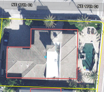

Hi Ken so the feature is actually the parcel so, that's why I think it does not need the intersect right?
The parcel can be seen in the yellow boundary, the other two are the intersected layers i.e., the buildings and points.
And so the popup appears when the user clicks on a parcel as shown below:

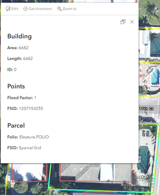

Is this popup for the parcel layer? If so, then you'd just need this
popup += `<b>Folio:</b>${$feature.FOLIO}<br><br>
<b>FSID:</b>${$feature.fsid} <br><br>`

Happy Monday @KenBuja hope all is well, I have a follow up question so, let's say my popup is getting too big (too much scrolling) then, is it possible to add page breaks (add pages) to the popup?
Maybe something similar to this?
