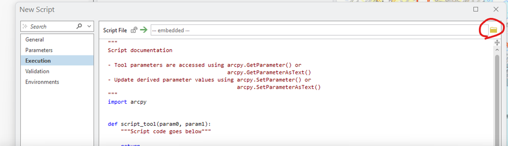

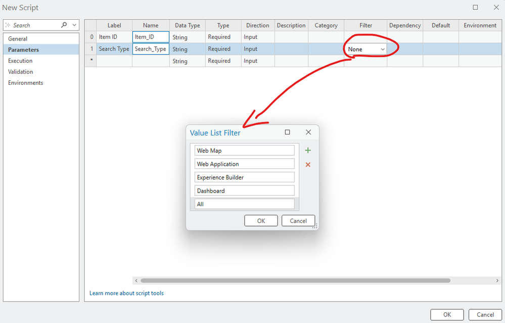

Made my own script that can search for "Web Maps", "Web Application", "Experience Builder", "Dashboard" or "All".
1. Open notepad, pase the code below, choose "All files" save as your desired filename and location. Remember to add .py at the end of the filename
2. Create a new toolbox in ArcGIS Pro and remember to add the parameters.
3. Link the toolbox to the code you saved in step 1.
