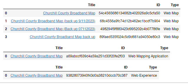

I've used this script to great effect over the years. Thanks to all who have contributed to it. I just wanted to post my slightly improved version that includes Web Experiences (kudos @Big-Chill), Web Maps, better exception handling, and hyperlinks the titles (in Jupyter Notebooks).
Output should look something like this:

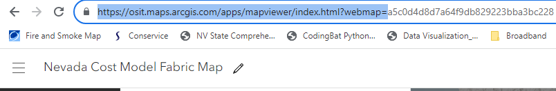

lzk222
Hi @MichaelRobb2 ,
The best place to run the script is in Jupyter Notebooks
The portal-url should look something like this:
https://osit.maps.arcgis.com/apps/mapviewer/index.html?webmap=
You can find it from any webmap in your organization.
Please try running it from here. If you're still getting errors let me know, though what you've posted appears to be firewall related.
