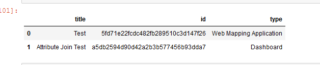

The output DataFrame will be any apps that reference your layer:
You can easily amend the final line of the expression to include additional details about the items.
