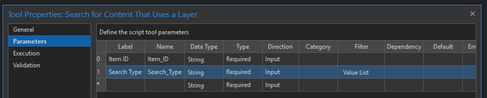

Since @jcarlson was so generous with sharing his code, I'd like to share what I did to take it a step further and set up this tool so that others in my organization who didn't have programming experience could search for items. (setup for ArcGIS Pro)
When setting up the tool parameters, I entered "Web Map" and "Web Application" in the Value List I created for that parameter. This creates a drop down in the tool and ensures there won't be any typos in the user input that would break the code.

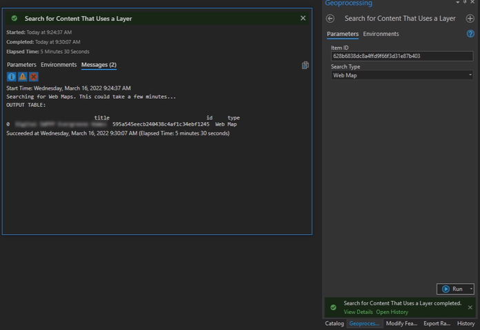

Also, if anyone reads this who is completely new to Python, I wanted to point out that when setting up tools to use within Pro or ArcMap, you use arcpy.AddMessage() to print messages to the console instead of a traditional print() statement.
And this is what the output looks like (nothing fancy) - this particular layer is only used in one web map. (side note - the time it takes to run depends on the number of items in your Organization's contents. It may run much quicker if you have fewer items to search through).
