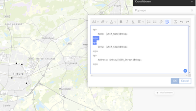

AntoinevanEsch
Hi,
There is an easy way to remove the spacing. Go to the HTML section in the text pop up. Remove for example the highlighted area as you can see below and add <br> between the parts. Now the spacing is removed.
Hope this will help 🙂
AllisonWebb
How do you save the HTML section once you add the <br>.  The OK is greyed out.
AllisonWebb
I just had to close it...  🙂

AprilPearce1
you don't click 'ok' you click on the 'source' button you used to get to the html - it took me a minute
